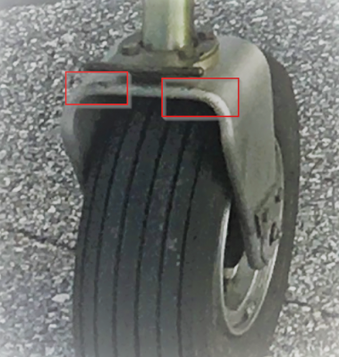

I'm going to speculate the bend was so that tow bar didn't scratch the nose fork (which does on my Legacy with flat plate).

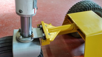

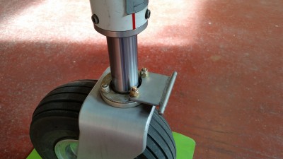

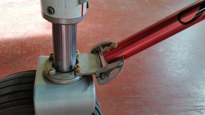

Paul, not sure what the difference is but mine doesn't interfere at all, with either the tow bar or the tug. The dimensions of my newly fabricated plate were taken directly from the original one. I wonder if dimensional changes were made by the factory somewhere along the line when they put the 45 deg bend in the plate, given that your tow bar interferes with the nose gear fork???

this is the flat piece on the Legacy. the red boxes occasionally get scratched by the bar when installing. I bet larger tow bars might interfere also. I think the cutout could easily be duped by the guys who cut my panel (they love repeat jobs on their CNC) but I don't know who would do the welding. I'm guessing the metal cutouts with holes drilled at $5-10 each delivered. The attachment bar and welding is another step.

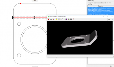

Just for fun, I created a job on eMachineShop for a visually similar product. Steel, 0.25 thick, some holes and a bend. It is not accurate. It is just for demonstration and pricing. The cost is around $25 delivered for this piece in lot sizes. The pin would have to be added/welded or possibly machined in place.
That gives us an idea of what the plate should cost. About a week to deliver.

I see Chuck's photos. Should be easy enough to make, from that. Thank you.

Scott, I don't know whether the IV uses the same nose gear assembly as the Legacy, but I can give you length and width measurements of the plate and length of the rod if that would be helpful. The back side of the plate just has to be shaped as seen in the photo.
